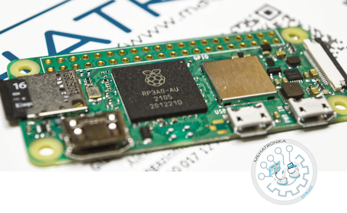

And then 2021 came, and we got the long-needed spec bump to the Pi Zero – the new Raspberry Pi Zero 2 W, which now features a quad-core 64-bit BCM2710A1 processor, based on the Cortex A53 architecture. This is the same chip we’ve seen previously on the Raspberry Pi 3 – but slightly underclocked to 1 GHz on this new model. What’s lovely is that the physical dimensions and connections have stayed exactly the same. This means that the new Zero is a drop-in replacement for the old one, making migration that much easier.
The two micro-usb ports, a mini-HDMI port and the CSI connector all stayed, and are in the same position. While a more modern range of IO would have been nice, it’s useful that nothing changed, if only for compatibility’s sake. Sadly, some cases seem to not work with the new model due to some components being shifted around (most notably the Pi 3 Model B+-esque metal antenna cover). The new RAM placement solution is also interesting – as it’s integrated together with the CPU in a SiP configuration. Sadly, though, there’s only 512 MB of RAM present here, and it’s one of the main features holding back performance.
